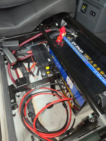

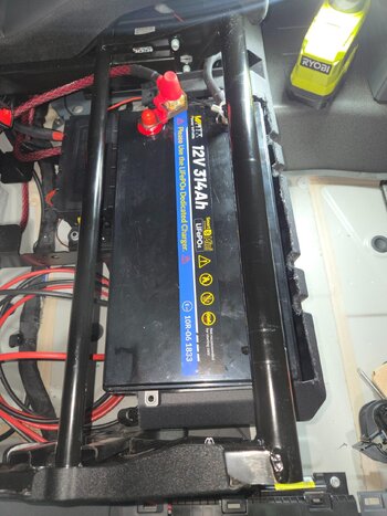

I wonder if i should upgrade my standard auxiliary battery with a Victron Lithium Battery Smart 12,8V. In 200 Ah it has the dimensions of 237 x 321 x 152mm. Will it fit? Has someone fitted one of these already? What's the maximum dimension that fits under the rear bench?
John from Agile Off Road has the Victron 200Ah in the OEM-ish location.
The Dakota Lithium 135Ah has plenty of extra room (laterally)
Do you have pictures?
Here's a photo of John's vehicle with the full Victron set up:
He also has a Multiplus 12/1200 where the factory inverter was that supplies 110v power and acts as a mains charger as well

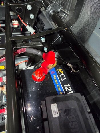

My Grenadier came with a battery already installed in that location. I think it is an AGM battery. I was going to take it out and put in the Victron lithium battery. However, I think the winch also runs off of this battery. Is it OK to run the winch with a lithium battery? Does anyone know if the winch actually runs off the secondary battery?
Everything runs off the main. The secondary trickle charges the main.
