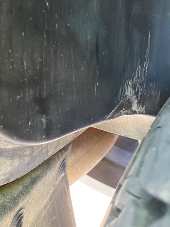

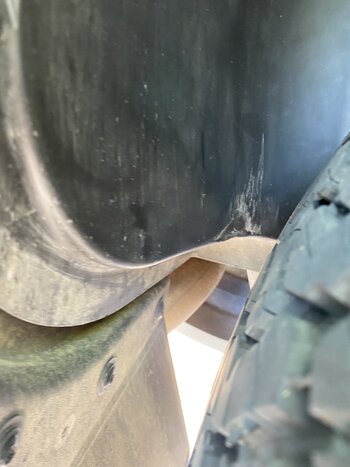

the problem is caused by the misalignment of about 10/15 mm of the spring + relative rubber support on the frame. in my case the right spring is completely off-center to the right and touches the frame.
I should disassemble it and try to center it but to date I haven't done it because in my opinion it doesn't create problems in the guide.
however, I don't exclude that the noise is simply created by the last coils at the top being very close to each other.
I would also be curious to understand how the upper part of the spring and its rubber support aligns and joins the frame. It seems strange to me that mine has moved since even in twist the spring does not move.

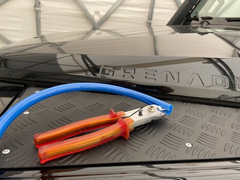

You can search Tein silencer or alternatively insert a heat shrink tubing between the tightest turns
I’ve been looking for coils sleeves and have looked at Tein and even Eibach brand sleeves but none of them are available in sizes that will fit the thickness of the coils on the Grenadier. Most sleeves max out at 0.500” wire size thickness and the rears on the Grenadier are closer to 0.700”. I bought the biggest wire size Eibach ones I could find just to try and there is no way it will fit on the rear coils.
I also have these noises on the rear springs but at the moment I'm busy solving another indecipherable noise.
Later on however I would like to solve it by inserting a polyurethane compressed air tube cut on one side or better in a spiral perhaps with the addition of a heat-shrink sheath to fix it.

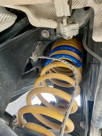

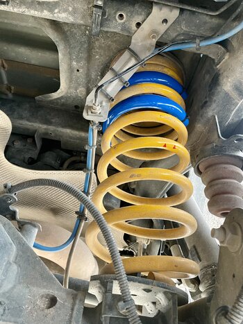

It took me a while to get round to it but here is a quick update and some pictures on how I solved my clattering stock rear (red triangle) Grenadier springs under light load. I installed just one loop of Eibach part #: CS5002L isolators starting at the second full coil near the top of each rear spring. A little fiddly but easy enough to do if you jack up one wheel at a time until it’s at full droop (use jack stands for added safety). You don’t have to take wheels off or anything just slide under and install them. Now they are completely silent and don’t clatter at all as I noticed the noise most at very low speeds going over a sharp bumps.

Interesting… I thought most of the aftermarket Eibach kits for the Grenadier included spring isolators near the top of the coils? I could be wrong on that but I do know the stock Eibach springs from the factory don’t have them. I find it odd as they are progressive springs (at least the double red triangle ones I have on the rear are) where the coils are more tightly wound near the top and can chatter against each other.
Mine clattered around a bit when the vehicle was lightly loaded and after putting on a couple of isolators they’ve been silent since. I figured it out after driving around with some cargo and passengers in the back I couldn’t hear the noise anymore. I assume the extra weight was compressing the springs to the point the first few coils were fully touching making them run quiet.
Needless to say, installing the isolators is pretty straightforward you can do it without removing the springs using a little bit of dexterity but certainly worth the effort.

Hi OSRO, did you ever sort the issue of your spring rubbing on the frame? I have this issue which has started just after getting the taller eibach springs installed. Waiting to hear what the installer says but curious on your case in the meantime. Cheers
hi, no in the end I didn't touch the rear springs anymore because in my case the noise I was trying to identify came from another part and looking in the underbody I also came across the rear springs. actually taking certain types of bumps on the road the rear springs make a slight noise because the upper coils resonate with each other but having a plan to update springs to shock absorbers soon and not being a mechanical problem I left them as they are. also the fact that one is slightly misaligned with respect to the other does not create any kind of problem.
