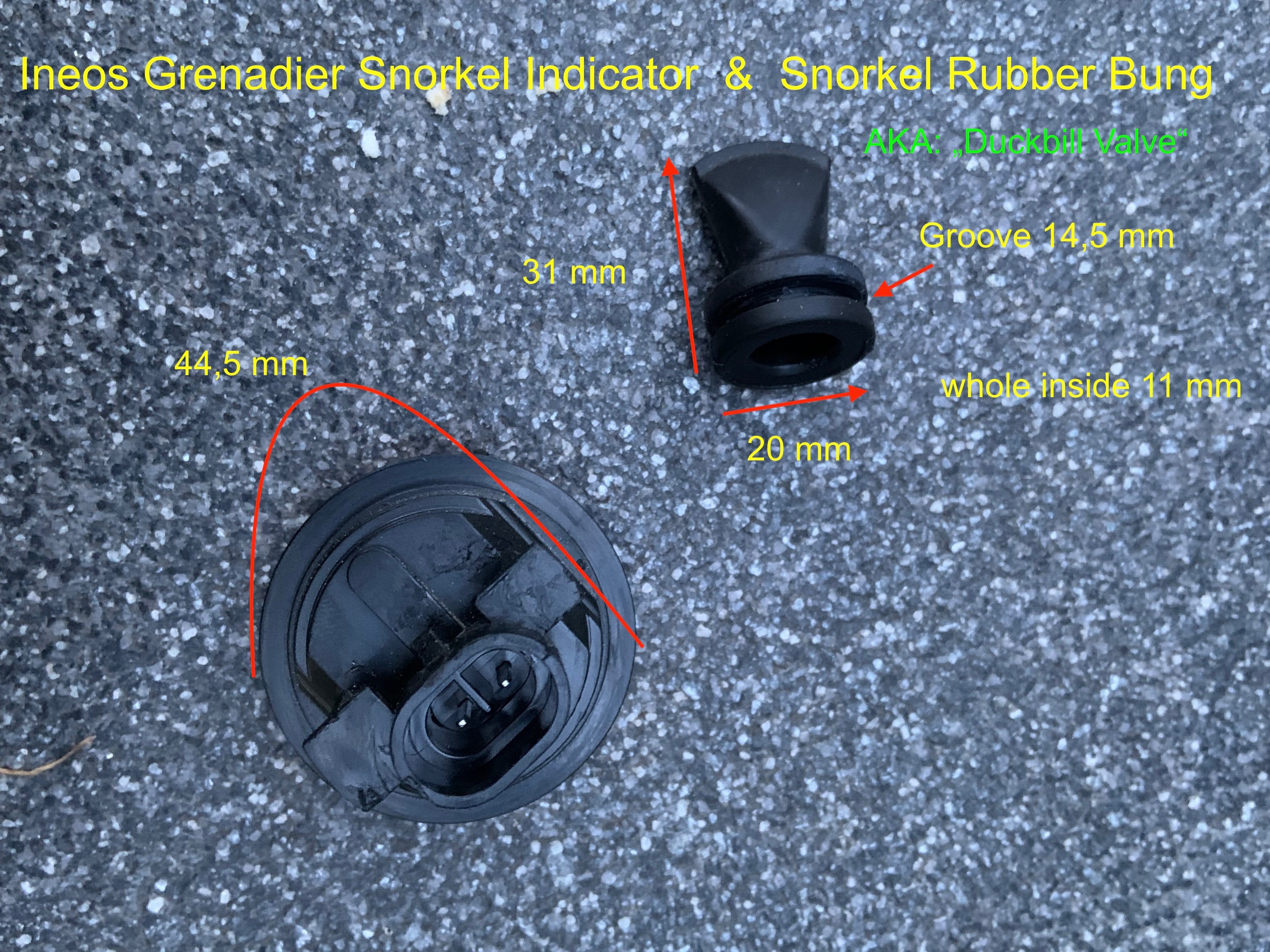

do you know how to disassemble the RAI light?
Thanks
The indicator has a bayonet fitting. You can unlock and remove the indicator by turning it to the right.
