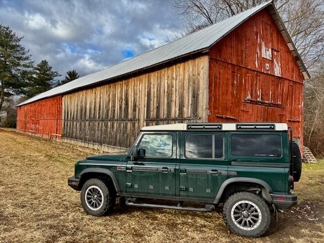

Should be same design as the cross bars for the 3/4 + full rack, but with only one t-slot as they are narrower (leitber rail on the right).
I just ordered the 3/4 rack - they only go on sale twice a year.
