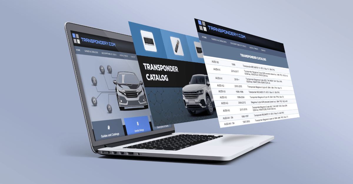

The below link shows all of the various transponder references for the different Peugeot keys. I am on the road this week so I don’t have my key, but if anyone has opened up the key and could post a picture of the FCC number of model number I can likely narrow this down for a real answer.
