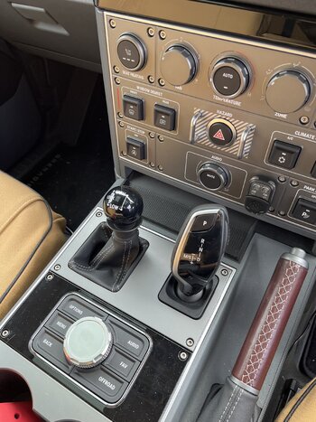

Hi Adam
Assuming that the question comes from India and the vehicle is right hand drive as per my vehicle. To engage CDL I have to push the lever left.

Hi Adam
That's so interesting - I never imagined they would make a left and right hand drive transfer case.
In that case you are spot on!
