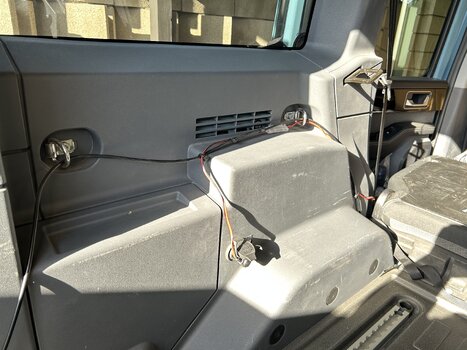

Chose to go from passenger side, since I wanted to mount the radio under the passenger side footwell.
Follow the same path as one of the forum members. Remove the screws and the pull the coax under the trim.
Then I use the grummet to pull into the wheel arch than toward the rear passenger floor.
Groummet, poke a hole, pull wire, reseal.
Front passeger, you can remove all this and pull wire underneath.

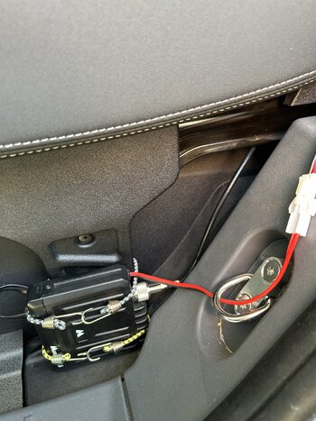

I have now moved my MXT-275 to the side of left hand “leg” of the rear seat (floor level) and plugged the power cord into the load bay power point in the rear. No issues with alternator ‘whine’ and no need to connect (or bury) any wires.
