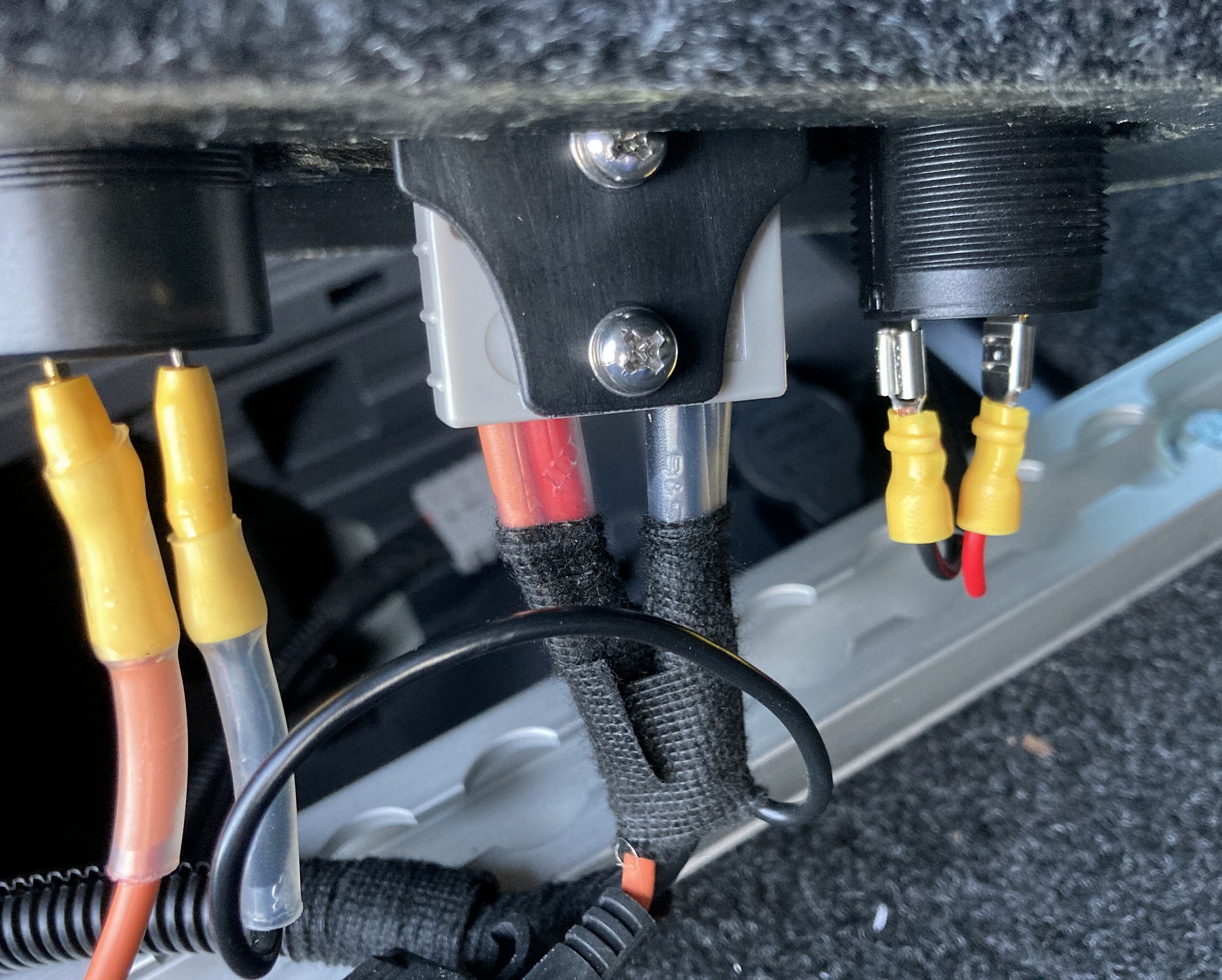

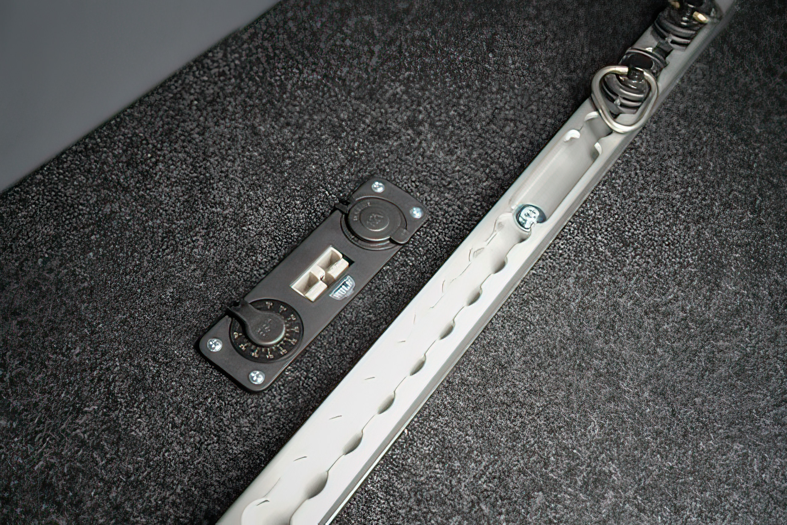

Yes, you can. The only issue with doing so is that the cigarette lighter socket is a poor choice if you are likely to encounter rough conditions - they can be insecure and delicate versus alternatives.
I replaced the stock cigarette socket in the rear loadspace with a dual Anderson/cigarette socket fitting and attached the fridge through the more secure Anderson connection. This worked fine across Australia, and I particularly liked the convenience of switching the fridge from the overhead console.
It’s an easy modification to DIY and gives peace of mind that you won’t arrive at your destination only to find the fridge unplugged itself.

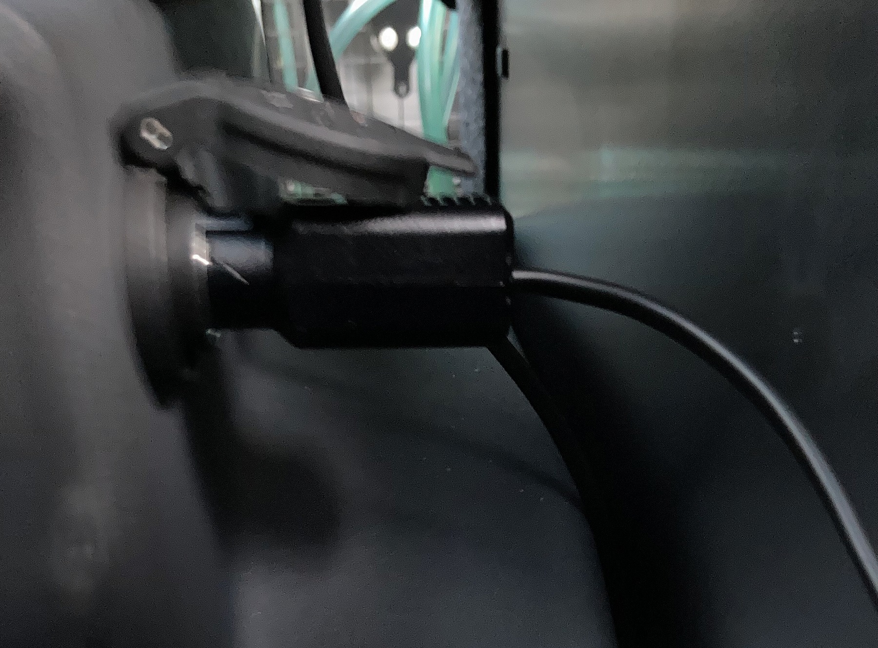

Neat idea replacing the cigarette plug. I like it. Likewise I’m finding it’s all too easy for the plug to disconnect in the 12v socket. I was going to replace it with a merit socket but you’ve now got me thinking.
Cheers
Steve
Cheers
Steve
I use an Anderson circuit and the INEOS fridge socket to power my rear power panel. The INEOS Fridge circuit powers cig/merit socket. The USB and Anderson come from the Anderson circuit. So two circuits supply the panel. Both leads can be unplugged and the panel removed, if needed. It works for me.
full
full
full
Thanks for this reply. Really useful.
