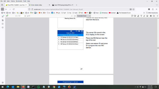

Looking for someone w/ early Autel TPMS program unit / software, who can assist (paid) in manually programing Autel MX-sensors to OEM TPMS unit codes for a second set of wheels. I pulled the OEM TPMS unit codes using a Sept/24 purchased TW508WF but auto create is the only option available on my 508 to program the MX-sensors. I have the MX-sensors (actually two sets - don't ask) as well second set of wheels and tires. FWIW I'm heading to Moab 4/29-30 via Albuquerque and returning 5/5-6 via Denver and could meet up in Moab or space between. Any assistance would be greatly appreciated! Cheers!

That means you have one that has the latest updates... Sometime between last April/May and the end of the year, they pushed an update that removed the ability to clone sensors
And I take it the new software written sensors DON'T pair with the vehicle?
The sensors can be paired to the vehicle, however, it would have to be done the traditional way at a dealership.
I was able to clone @mccasksl 's sensors @ the Moab event with my (not updated) TS508, I know several people have posted on here with non-updated units that have been willing to assist local folks to them
Anyone local in Austin? I have read the numerous TPMS threads and even decided to pull the trigger on the wildly more expensive Autel device as well. The TS600 Pro I believe.
Yes Anand (many thanks!) cloned both a set of Autel sensors mounted in my second set of wheels and a spare loose set of Autel sensors to match my OEM sensors in the OEM wheels and tires. I can now swap out wheel sets and get accurate TPMS readings as long as they are returned to the same corner w/o a trip to the dealer. My Autel TW508WF purchased 11/24 with ver 1.27 software will not clone OEM codes/sensors, you need ver 1.26 or older. But not too much older as Ineos Grenadiers are relatively new to Autel units. The forum has a number of members having older Autel units willing to help clone Autel sensors. Check out the numerous related posts for discussion. You may have to send a lose set of sensors to someone to program / clone. You just need to interrogate the OEM sensors to get the codes for them to clone. You can interrogate the OEM sensors with the newer TW508 units even if you cannot clone them. I have not found anyone in Austin w/ the older Autel units / software. PM me off list if you have any other questions.
