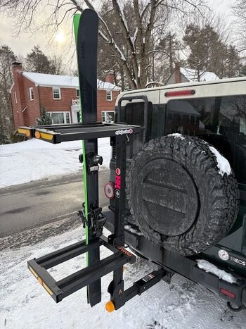

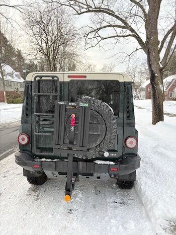

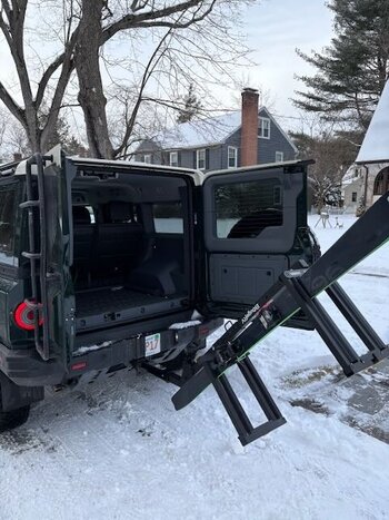

This is the BougeRV R0206-0025-BK. It needs a receiver extension to clear the spare tire. A 7" extension works, and a 12" extension lets both doors open when you tip the rack. I'm adding a Curt anti-rattle pin tomorrow that should straighten it up and prevent any movement. It feels surprisingly sturdy, but it probably won't last for more than one season because the paint is already peeling away in some places. I also need to find a good way to protect the bindings. I'll go with trash bags and duct tape for now!
