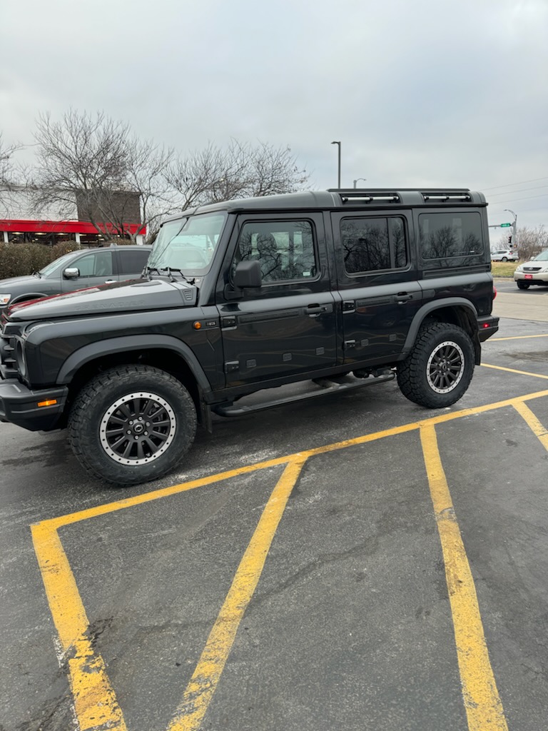

Vehicle is at the tire shop now. Went with 285/65/18 Nitto Recon grapplers. Will upload pics after I pick it up.Update?
Looks amazing!Here's some pics. Bottom pic is the before.
View attachment 7838146View attachment 7838147View attachment 7838148
No fitment or rubbing issues. That's why they recommended 285/65 instead of 285/70. Said 285/70 would rub.Looks amazing!
Let us know if any fitment/rubbing issues, but highly doubt it.

Any rubbing issues in the fenders or with the rear door??Nice! I have 17s and went with the 295 70r17 KO2s. The extra inch or so under the axles is nice.

any issues with the rear doors? (i doubt youd do it if there was, but had to ask as i am getting new tires soon!)Nice! I have 17s and went with the 295 70r17 KO2s. The extra inch or so under the axles is nice. Stu's on the left with stock 265s, mine on right with 295s.View attachment 7838156
None. The clearance is fine. There's about a half inch to go before interference.any issues with the rear doors? (i doubt youd do it if there was, but had to ask as i am getting new tires soon!)
