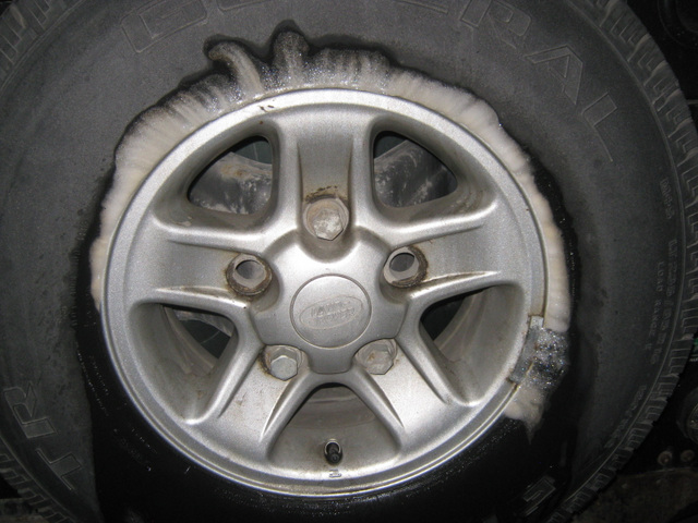

I prefer steel wheels for following reasons:
  • The weight difference has no practical or measurable effect on fuel consumption, unsprung weight, or anything else.
  • They are more robust for off-road use.
  • They are easy to refurbish when corroded: sandbasting and two-component epoxy.
  • When older they don't leak at bead like alloys.
  • If damaged the can be repaired in field conditions,
Leaking alloy wheel:
