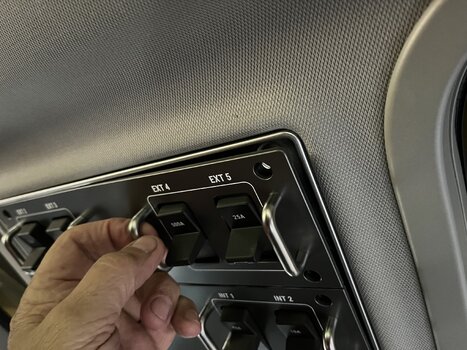

I am trying to pull down the overhead panel in the pic...there are 12 screws that i removed, but something is still holding the panel to the ceiling of the Grenadier.
See pic...what else do i need to do?
There are clips holding the panel in place still. Use a plastic pry bar to lever the panel off or your fingers to gently pry the panel off. You'll then see the two screws you need to remove to drop the inner panel and expose the wiring.

On my Grenadier there is no need to remove screws, they are for looks only, nothing more. I use a trim bar or my finger to grab a corner and work it across they pull down on everything. I have taken my overhead down several times. I ordered the overhead in Black stainless, however it only has one row of switches. I need two rows. RockFoxx.com is working on that.

Not on mine, I removed them once and realized these screws are for looks. They are fake. When you look on the inside, you see the screws go nowhere. Use a pry bar at the end towards the 2nd. row, pop it out and everything will follow. I use a cardboard box on the lip of the info-screen to help secure the control panel its long and I don't want it hanging by wires. When I get my stuff from RockFoxx I'll take photos and post them.
